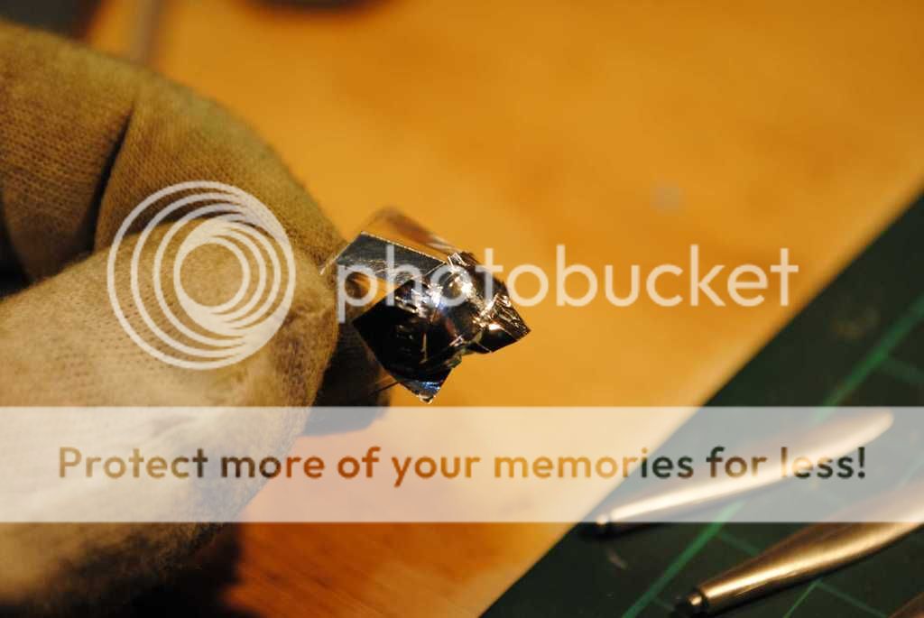

The way to use it is to cut a small piece of foil from the sheet that's big enough to cover the panel you wish to protect from paint. In this pic, I've already done the front windshield...

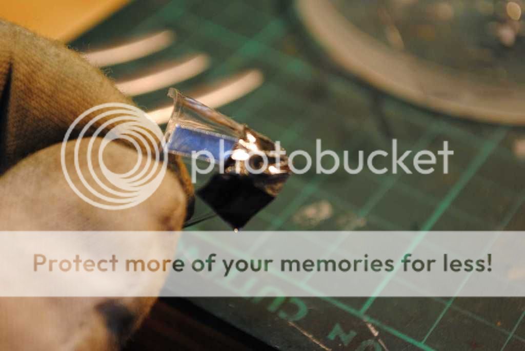

Remove the foil from its backing sheet and roughly place it on the clear part.

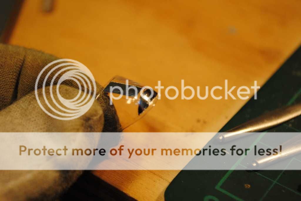

Then burnish it down on to the surface with a cotton tip and then when it's pretty flush, use a toothpick to gently push it all the way down to the edge of the canopy frame. You should end up with something like this...

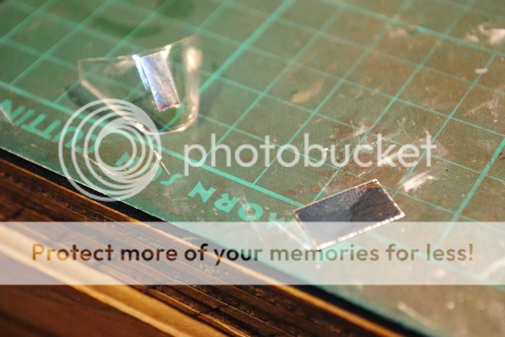

At this point, it's fairly easy to use a brand new blade on your trusty hobby knife to cut the foil along the edges of the canopy frames. When you're finished, it should look like this...

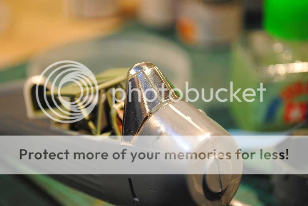

Do the same for each "glass" panel on your clear part and voila...
The Bare Metal Foil is easy to use, not too sticky, will conform to complex curves or any shape at all really and it very forgiving to use. Its adhesive doesn't mar the clear parts in any way, even if left on for months and is pretty easy to remove even after several coats of whatever you shoot at it. I got mine from an online supplier in Australia but it shouldn't be too hard to get, particularly in the US and UK.
