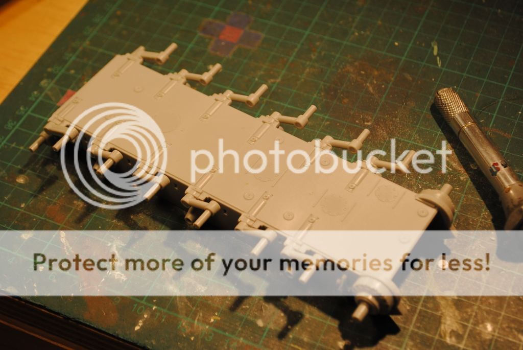

As I said earlier, the kit is pretty basic so I'm not going to post blow-by-blow pics. Incorporating the parts from the Voyager set is of interest though.

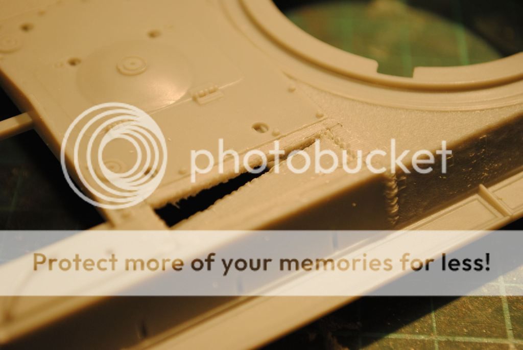

The grilles over the engine are moulded on to the main upper-deck part. They had to be shaved off with a small chisel. Once the area was flat, I drilled many small holes along the edge of the grilles in order to make a rectangular cut out ove which the beautiful PE grille assemblies would go.
Flat area with detail shaved off.
Chain drilled holes joined up to remove rectangular part. The hole was then carefully filed into shape.

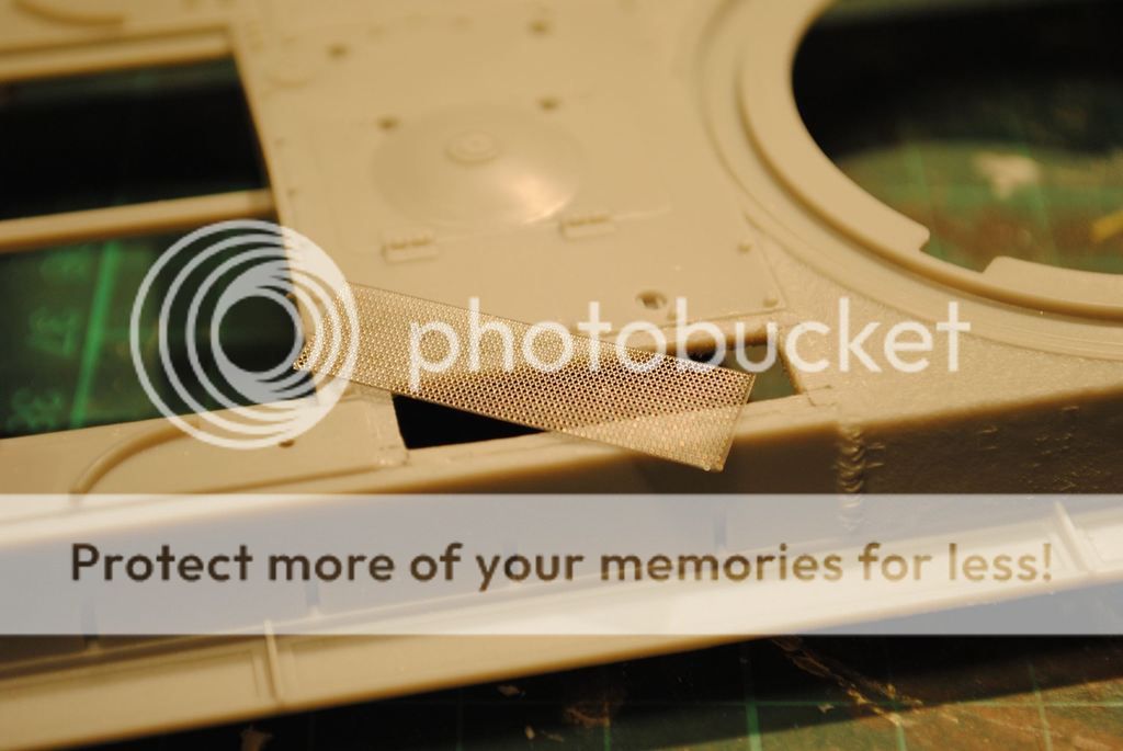

Openings with metal grille part.
