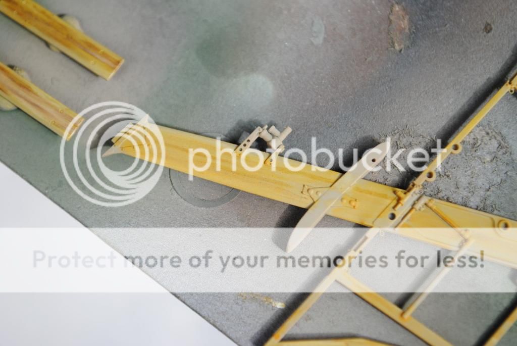

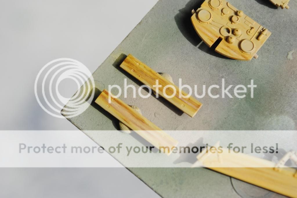

Here's a bit of progress. It's been slower going than I'd hoped lately with life intervening and messing with my modelling plans. I did however get a little bit done.
The above two pics show my usual wood grain effect. It's a Tamiya acrylic base of Buff with Burnt Sienna, White and Raw Sienna oil paint wood grain kinda painted on by hand. All of that is allowed to dry for a day or two and then I've given it an orange oil glaze which is paint diluted with raw linseed oil applied with a brush, allowed to stay on the surface for ten to fifteen minutes and then wiped off. To be honest, I feel like this technique has worked better for me in 1/48 and depicting blonder woods or darker tones that might be found in German propeller laminations. This honey coloured wood has eluded me for the moment and I'm not that satisfied with it. I plan to press on regardless because I don't want this one aspect to hold me up...I can always build another Tripe but rest assured I will be working to improve. I've seen some incredible wood grain effects and if THEY can do that...so can I.

Now that's the spirit, mate!!! :D Couldn't have said it better, myself.
Actually, though I know where you're coming from, I rather like that honey colored wood effect....and beautiful work there! I just watched a YouTube video on washes tonight and I could picture the orange wash :)
